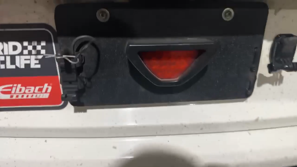

We’ve seen people mount them on their rear license plate area, attaching the clip below to a ‘fake’ license plate

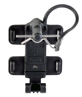

We’ve been told the Mylaps/AMB transponder clip also works with the Westhold rechargeable transponder. This clip provides a nice way to securely mount the transponder:
https://www.ogracing.com/products/mylaps-tr2-transponder-mount

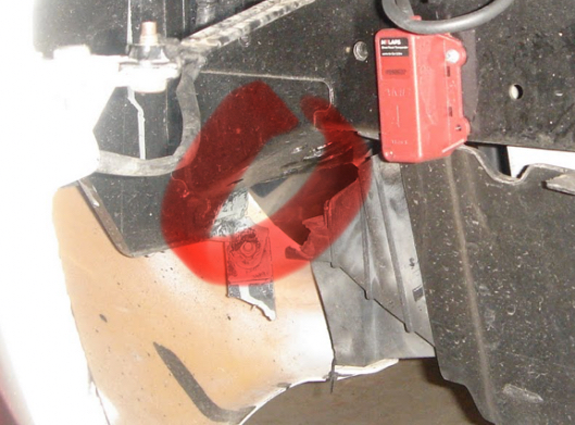

Location Suggestion
We emailed our vendor a photo of the AMB transponder mounted in my Miata and asked where he’d mount a Westhold hardwired transponder. He suggested: It could be mounted in the circled area.
It doesn’t have to be perfectly parallel to the track–you just need the silver label pointed towards the track surface. Remember that AMB transponders get mounted vertically while Westhold hardwired transponders get mounted horizontally (with the label facing the track).
